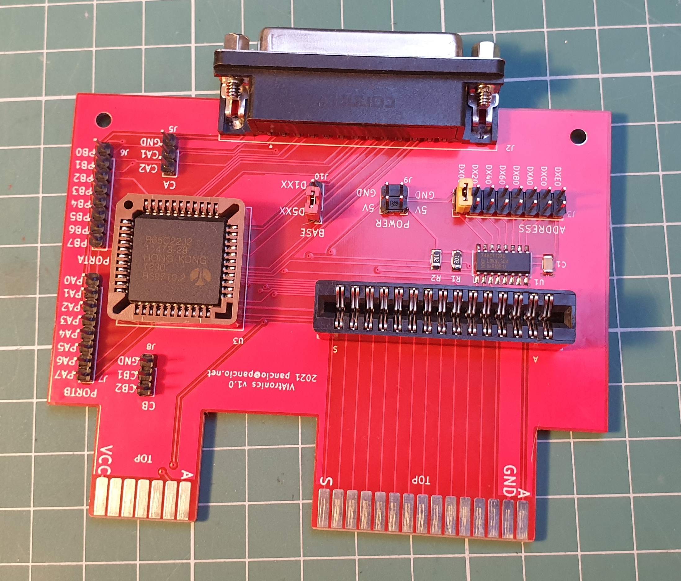

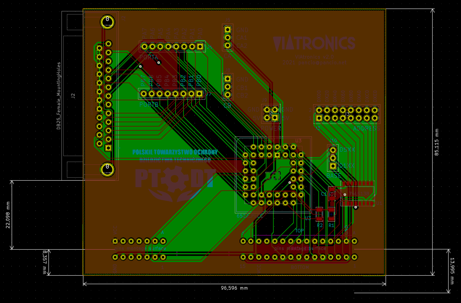

Introduction Inspiration for this mode was nightly discussion with some friends and request to make device which will be capable to connect ant EPSON/IBM printer to Atari. We had MicroPrint on the market in the past but nowadays it’s rather not possible to find it and use with any printer. In case I developed VIAtronics – it’s combination of VIAtari (presented years ago) and Centronics (actually only cable from it). Idea is very simple: connect VIAtronics to CART/ECI with cable LPT (DB25) -Centronics (C36) and any printer which can emulated EPSON or IBM codes.

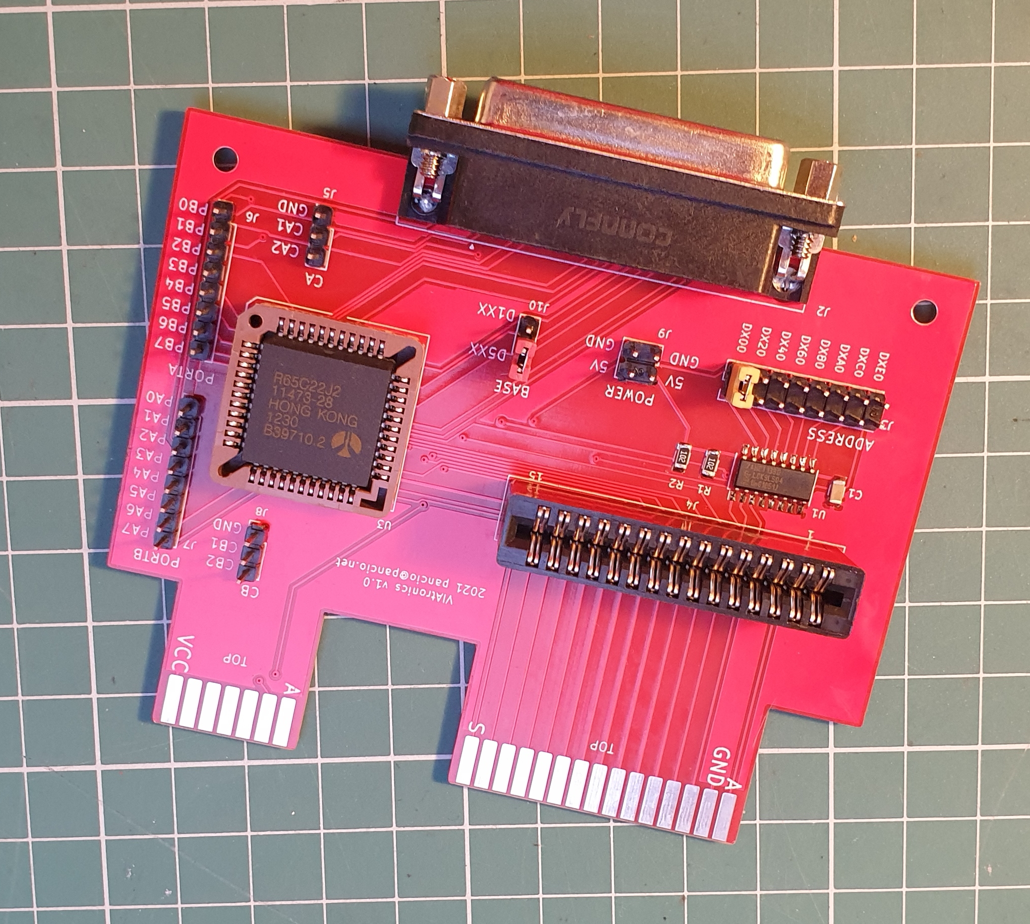

Hardware PCB based on standard CART/ECI slot contains VIA6522 two 8-bits parallel ports with control signals. Additional IC 74HCT138 is use as address decoder. All required by printer signals are connected to DB25 female port. On the PCB you may find selector for device address which can be selected from $D100-$D1E0 or $D500-$D5E0 with $20 step.Additional four pin header are connected to PA/PB/CA/CB signals and might be use for other task depend of your idea :-)If you are using cartridge e.g. Koala Illustrator or some text editor, you may use it together with VIAtronics but you need to check addresses used by cartridge to avoid conflict with VIAtronics.Project is made as Free Hardware - full documentation will be available on my page: https://systemembedded.eu

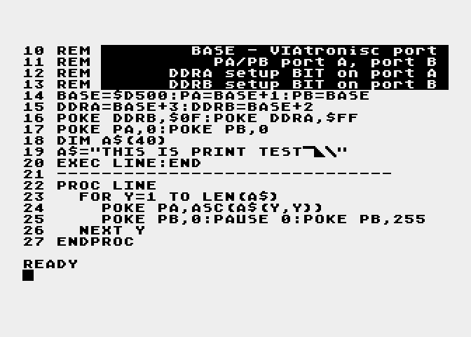

Software At this moment I use very simple program written in Turbo Basic XL which can send text/graphics to printer from memory. This is nothing spectacularly and anybody might write “driver” for any printer if you have instruction with steering codes. I checked EPSON standard on Star LC-20 whichwas very popular in ‘80-’90 last century...

VIAtronics in complete dummy device. Data to print (e.g. character code, byte for graphics, command code) should be written to PA - in case called data register. PB is using as control register and covering all printer signals e.g. /STROBE or /BUSY. So, during print, Atari sending data to VIAtronics all the time...

PS Ich sehe auf der Platine nur die VIA (der große eckige Chip) und den genannten 74HCT138 (der rechteckige Tausendfüßler). Kein ((E)P)ROM.

I translated your question, hope I understood good 🙂. VIAtronics is only codename for this interface but actually it's independent device which can be using not only for printing. VIA is connected directly to CPU bus using a few bytes from addresses area (can be changed by jumpers). Of course you may switch off EEPROM but I don't see any reason why? There is no conflict between cartridge and VIA if cartridge was designed with proper address decoder.. if not you may use different based on D1XX address. Moreover, as Mathy said, there is no EEPROM on the PCB, so anything what you plan to do with VIAtronics you should do by hand e.g. read data from ports is similar to read data from joystick ports - only register's addresses are different. Regarding examples... on my page you may find VIAtari (based on the same idea) which can be use with GLCD screen.

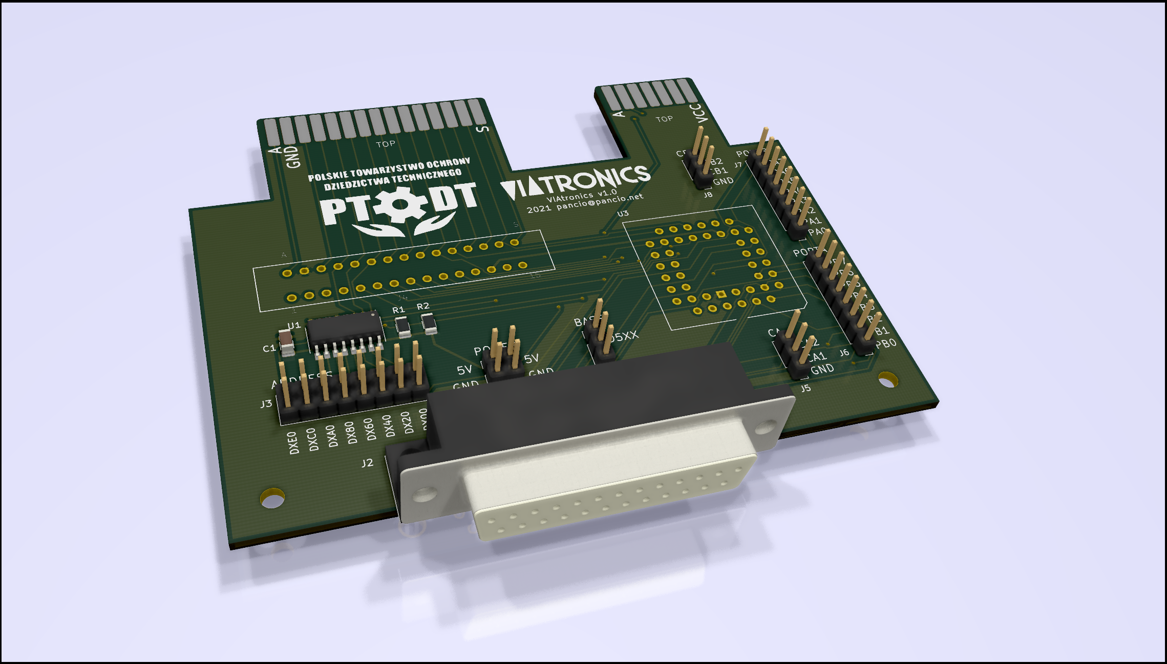

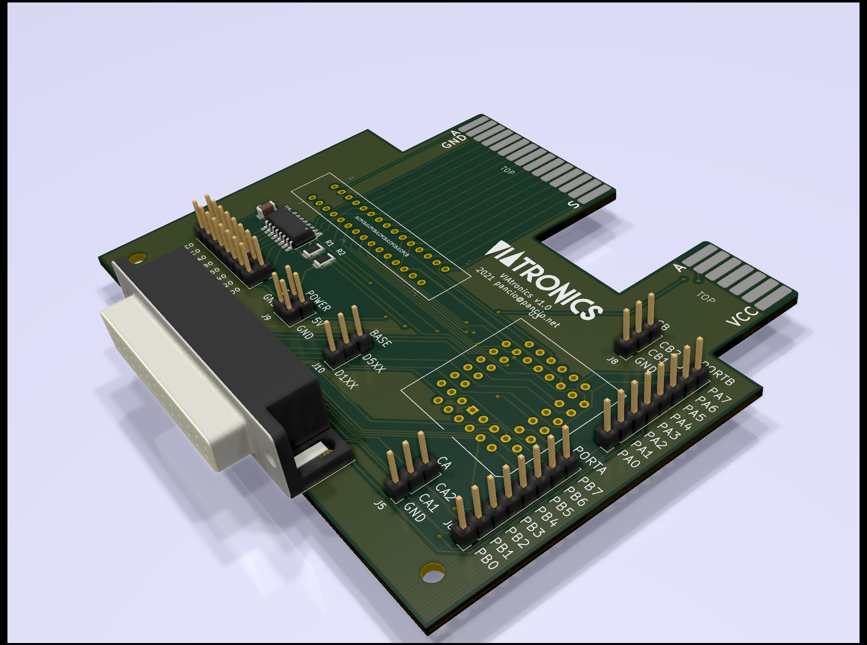

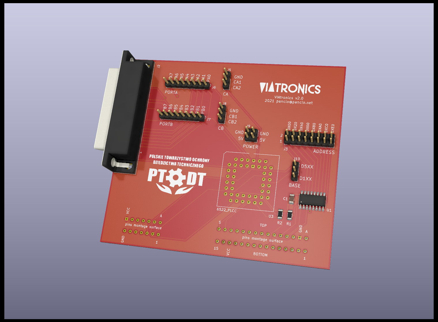

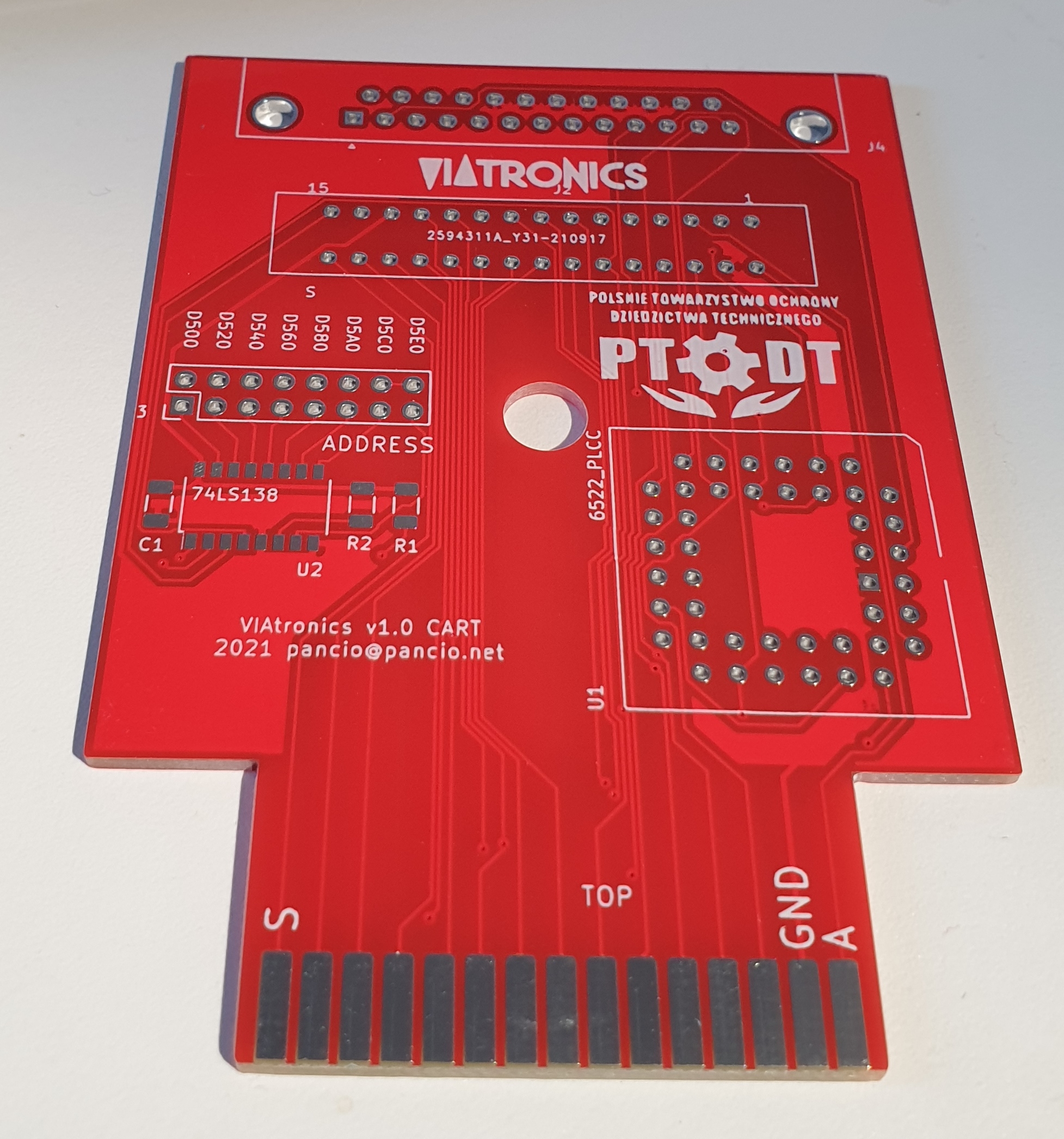

Hello, today I almost finished CART version for XE without ECI and for XL. Differences between CART/ECI version: - lack of signals /IRQ and /RESET - only D5XX addresses might be use.
I decided to leave CART slot but probably for XL models it will be little difficult to use it 🙂
If any doubts or advices, please let me know 🙂

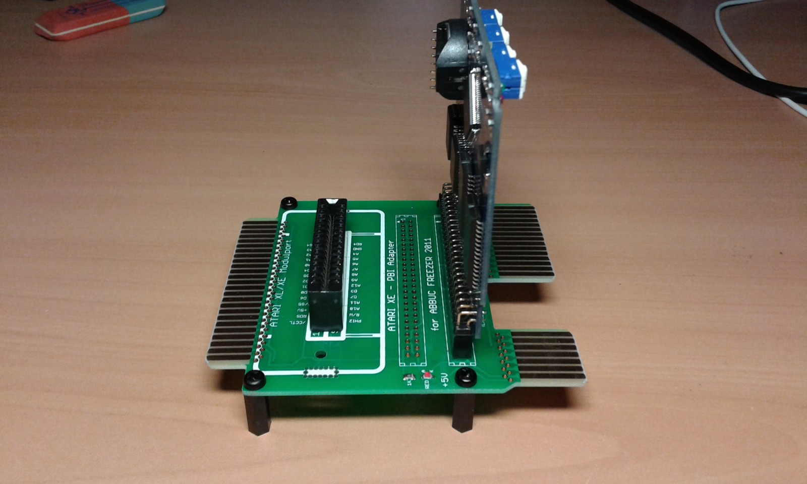

I think a regular PBI version would be the best fit for the XL. No limitations and right position. For the TurboFreezer, we had created a "gender changer" so, the actual PBI board was the same.
Hi JAC!
You have totally right but... CART version is cheapest, ready to use with all Atari 8 computers and is designed rather for print only (of course is possible to use signals thru DB25 with other stuff than printer). PBI version (with gender charger) will be probably the best option and I planned to do it soon. Could you please advise me where I may find correct gender charger? It will speed up working on PBI version...

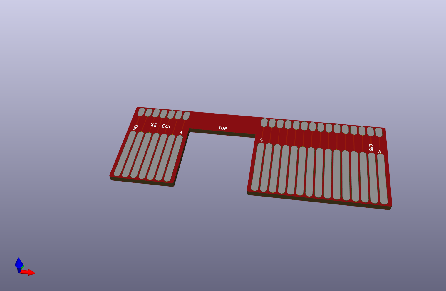

This is how it looks. A board with XE on one and XL on the other side. The actual board is plugged in there with a standard connector.
Very practical and good design for both kind of edges... As I understand, we need female - female slot in order to connect it to A800XL? Is this PCB available to buy or gerbers to make it own hands?
Has anyone footprint (module) for ECI (or CART/ECI) slot for KiCAD? I need it for newest VIAtrocics version with CART/ECI passtrue.

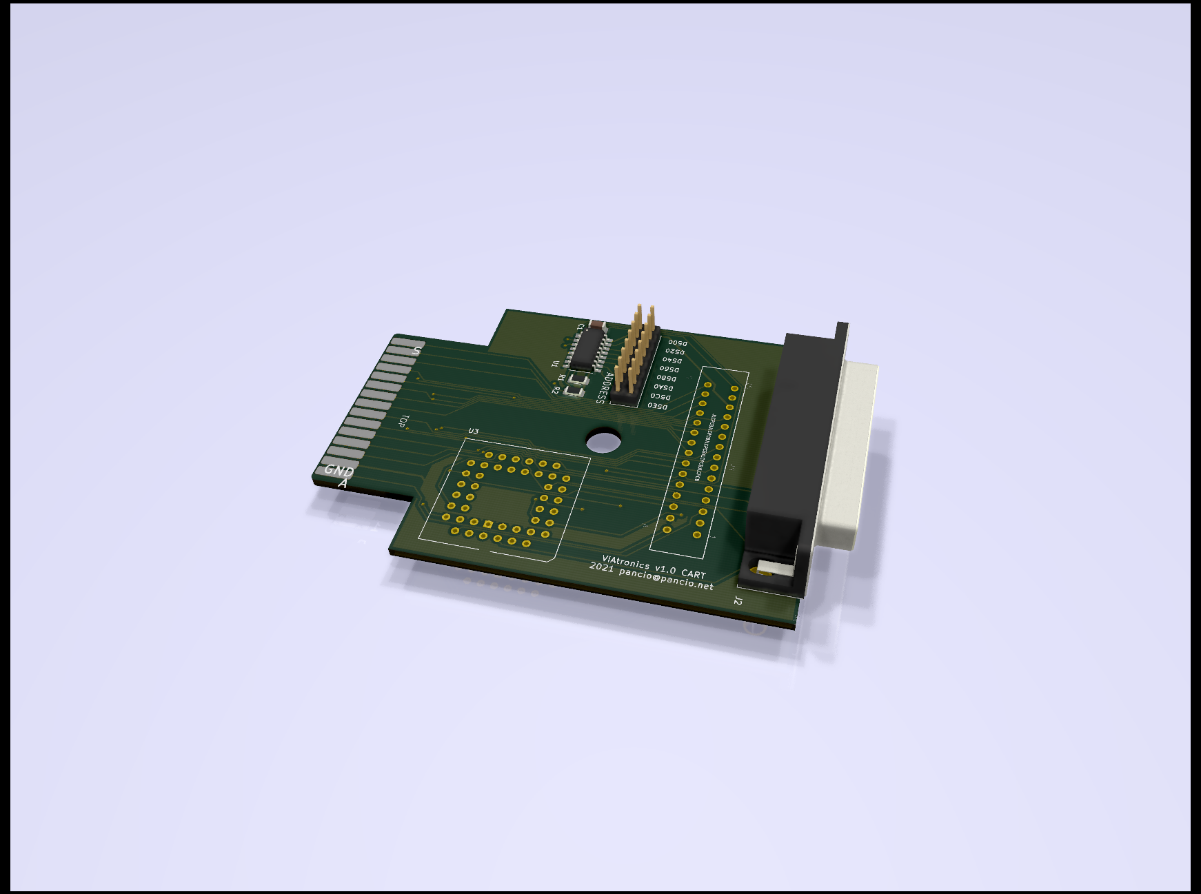

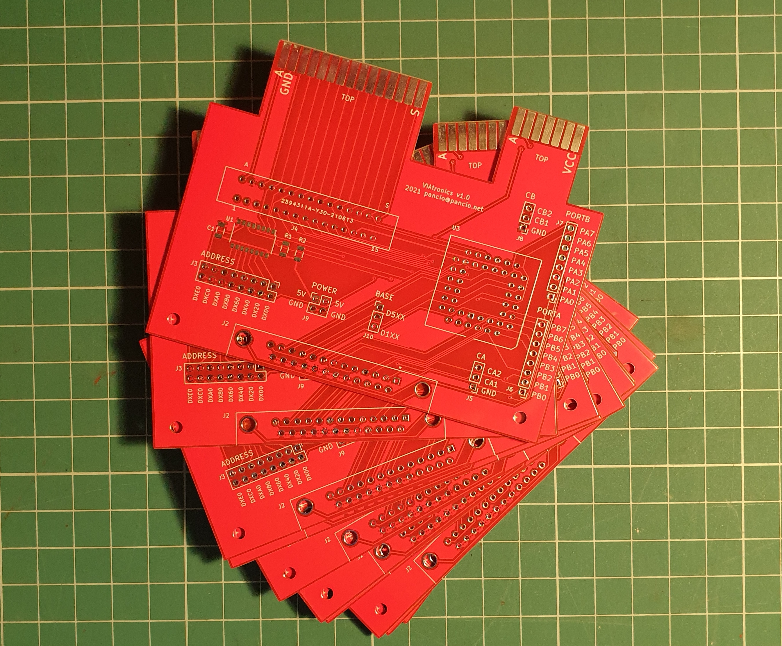

Today I received PCBs for CART version of VIAtronics:
I'll try to assembly it immediately and confirm work as ECI version soon 🙂 (I hope).

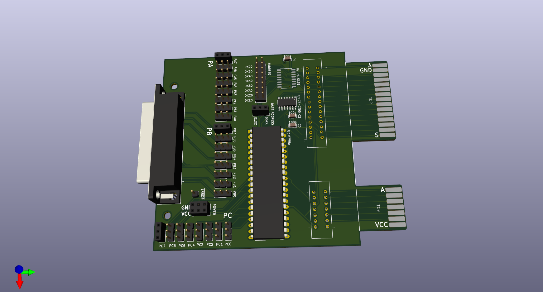

A few days ago I prepared little bit another version of Centronics for Atari. It's based on most popular, still available peripheral IC: 8255. It's more cheaper than VIA and very similar, so I propose to use it as alternative. Now I'm during tests. Software depends a few cosmetic changes, like set registers only. Rest procedures for printing will be the same...
Major differences in comparison with VIAtronics: - 3 eight bit Input/Output ports, - full CART/ECI pastrue - configurable Centronics pins
I'll add full documentation to my page soon.

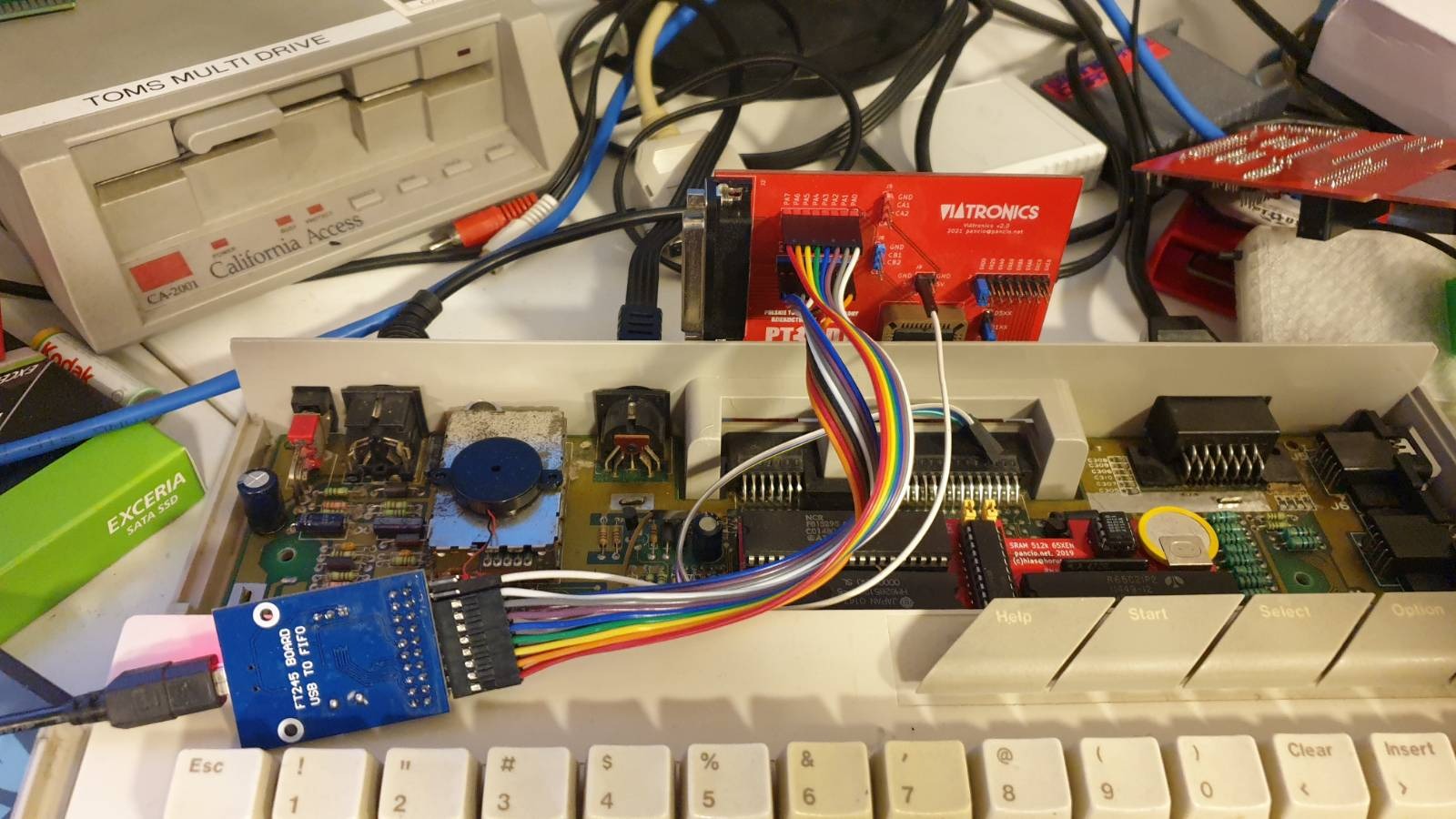

I would like to introduce new feature which is possible with VIAtronics. It's high speed parallel2serial interface based on FTDI FT245 chip and can provide data to/from ATARI with 1Mb/s speed. I did a few tests and results are very interesting. At this moment i wrote simple driver which is presents only transfer to or from PC and Atari but my colleague Lizard working on driver for SpartaDosX. I hope, it will be independent, more powerful interface than based on SIO port. Development version based on VIAtronics v. 2.0 but it's possible to use it with any version (e.g. CART version using DB25 male plug). Code name for assembled device is FTisXE. Take rest and keep your fingers crossed for the quick completion of the project 🙂

Hello,
Today I made some test with FT245 connected between Atari and PC on CART/ECI. I wrote simple terminal app (just for tests) and check transfers.. You may see result in short attached movies.
